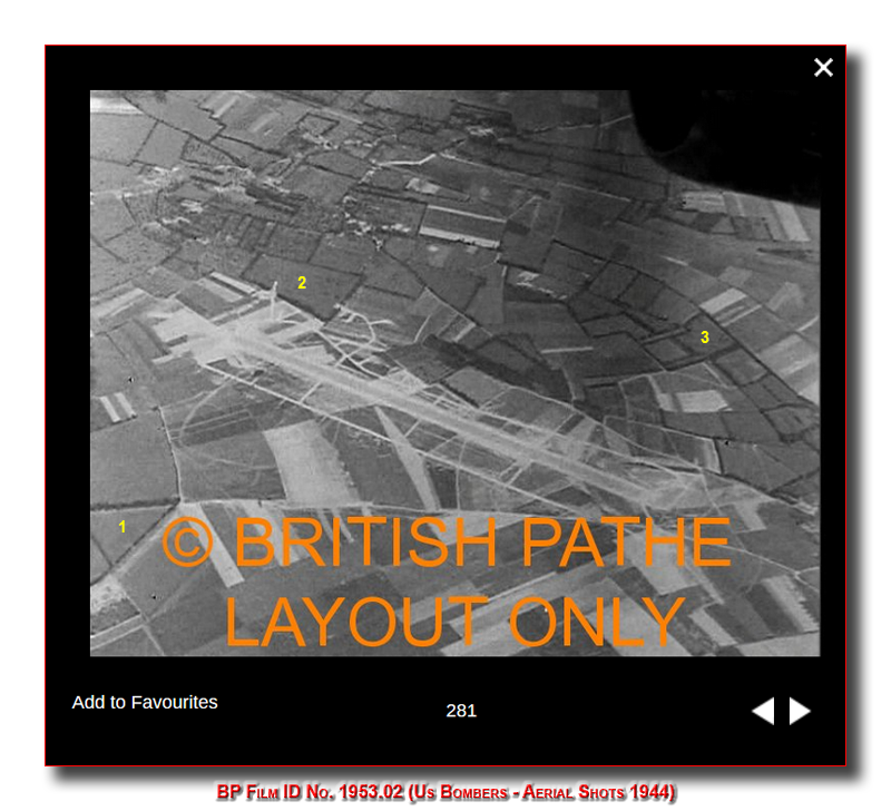

    In the BP footage there are 2 sequences where an air field is shown.
    4:39 to 4:42
    6:06 to 6:14
    I think chances are high the 2 series of stills are from the same airfield. Need to check the next days.

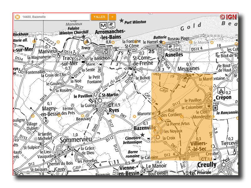

    The airstrip visible at 4:39-4:42 is the B2 Bazenville ALG. Very little of the strip is visible in the IGN cover from 1947 below but the the three field ties 1, 2 & 3 are solid:
    The other two screenshots you posted at first looked a bit like the south east end of Carpiquet Airfield, but on closer inspection they fail to match with available NCAP cover.
