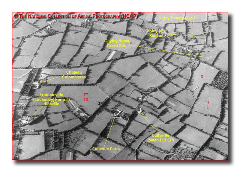

Hi Francois, I did check out your webpage on the research you have so far and I wanted to make sure you dont miss the aerial photo in the "NCAP High Resolution Frames" on the forum. Spcificly US7/1857 frame 4052. It covers the area in which you believe glider #29 landed. I already compared your overlay of landing locations of gliders with this aerial, but I dont see any immediate specific glider in that location ... But with the aid of many of the researchers here, and putting the pieces together, there is a good chance of finding it ! I hope you can share the overlay with those here. I look forward to seeing the progress made here. Respectfully, John Szweda

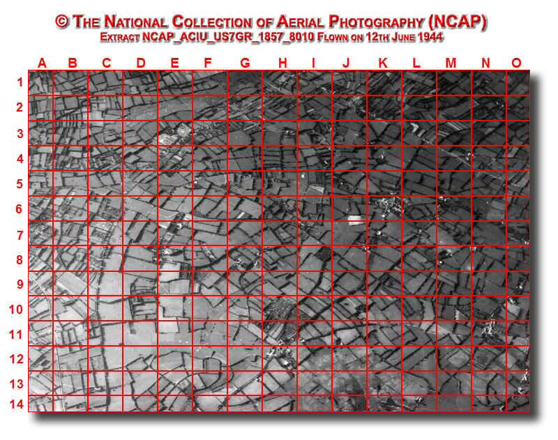

Hi Francois, Can you tell us where you are in your research to date on the grid below? The aid station your refer to is almost certainly the 101st Divisional Hospital at Chateau Colombieres - E6/E7 above. Regards, Pat
@John, I suspect you mean 4052? Found that and...... BUMMER ! Not a trace of activity in those fields. Even 6 days later I suspect there should have been some signs of gliders left..... :-( I see there is also a series of June 6th, albeit with clouds and higher up, but the part I am interested in is not listed. Thanks for pointing me to that list, I hadn't seen it yet! @Pat, I found the Colombieres hospital in previous research, but from the text from Bob it sounds like there was a place at Hiesville, in a farm's courtyard, where hospiks had set up a first aid station. It is also where Bill Brown apparently spent the night, before being taken back to the beach by German POW's. OH WAIT: that IS very close to the place I am looking at (and found by now) ! I am trying to find Hiesville on the grid map and will post the coordinates as soon as I recognize the field I am looking for It IS shown in the picture John pointed me to (US7GR_1857_4052), but it would be good to have an earlier shot of the same area to be sure the gliders weren't removed between 6 and 12 (which I can hardly imagine). Found it: F7, F8 is the field indicated on 'our' map...... Thanks for your kind help, Francois
Hi Francois, I suspect that the glider could have been pushed to the hedgerows if it didnt land at one already to clear the large field for later glider missions. There has been evidence of this happening already in the McCarthy or General Pratt threads, so it mat not be surprising to not find it immediately on the June 12th 4052 photo. Someone might be able to check a low resolution aerial from the June 6th photos and find a match, but I think I remember some clouds in some of those photos. Respectfully, John
John, I am working on several photos, and will upload the information I have received from Bob, so as to clarify why I am looking at that particular field. There should have been a number of gliders there actually....... and the one we are looking for would be into a hedgerow or a line of trees already, with tail removed ! The quest continues
Hi Francois, From your description, I would consider moving a little more to the east and having a look at Fields X and Y: Both have a mixed bag of Horsa and Waco gliders. Am I reading you correctly that the Waco in question lost its tail on landing? Looking forward to your photos Regards, Pat

Thanks Pat ! The other aid station sounds promising, we didn't know about that yet ! Lets see if we can better fit Bill's story into that location These are not on the photo of Hiesville I downloaded (4052). Do you have a photo number for me? EDIT: Never mind, dumb me. I noticed the number in the image name now <slaps forehead> Many thanks, Francois

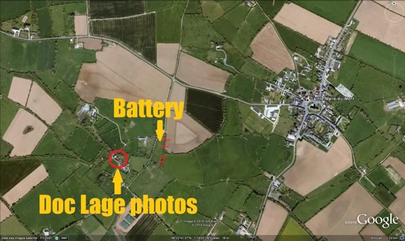

Hi Francois, The Holdy Aid Station was run by Capt. George Lage, surgeon of 2/502nd PIR and a team of medics under him. The house marked above is, as I understand it, the accepted location for the aid station in the hamlet of Holdy. However, there are three ground photographs in Mark Bando's '101st Airborne - The Screaming Eagles at Normandy' with captions indicating they were taken at this location. In my view, these three photographs do not match that house. I believe there is a better candidate a little closer to the fields marked X and Y above at the south western edge of the hamlet. This would shorten the distance from the possible landing field still further. Just an observation and I could be wrong. Regards, Pat

Hello there, To confirm, Lage's aid station, and the location of his photographs, was at the houses further to the west of the "gun field", as suggested by Pat above. Cheers, Sean
